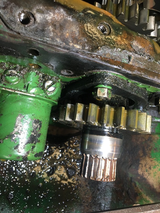

How to remove???
Posted by super99 on March 12, 2021 at 03:21:44 from (184.20.245.17):
I'm working on my Oliver 88, The splines are just about completely gone where the coupler goes on the input shaft to the transmission. This sleeve if where the oil seal rides. It has an o ring under it and is up against a snap ring on the shaft. It is stuck tight on the shaft, the only place to get behind it to pry is the gap in the snap ring. I blew the dirt out of the splines under it and have been soaking it with Aero Kroil for a couple of days. New ones are NLA. If I get carried away trying to get it off and scuff up the surface, then the oil seal will be damaged when installed on the new shaft. Any ideas on how to get it off?? Can I heat it enough to get it off without distorting it? I'm at a stand still until I get it off.
