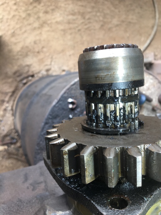

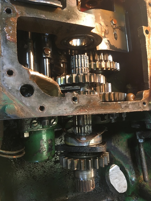

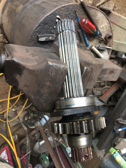

Got it out. I took the 2 snap rings loose on the transmission side the shaft and pulled it forward and then took the snap rings off and pulled it out. Put it in the vise and got the snap ring causing the problem off and the I could pry on the spacer and got it off ok. Waiting on parts to go back together. Thanks for the help. Chris
