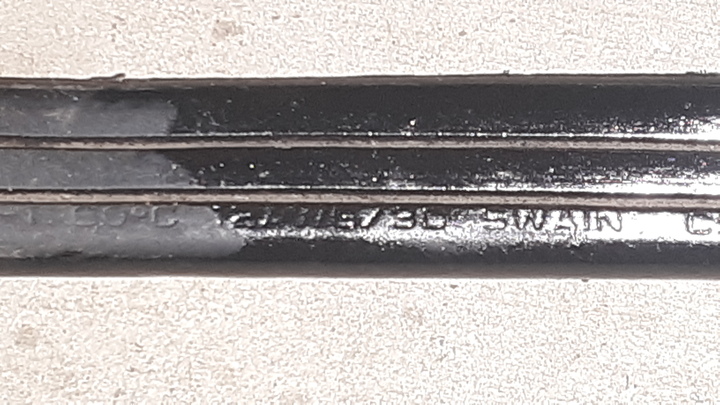

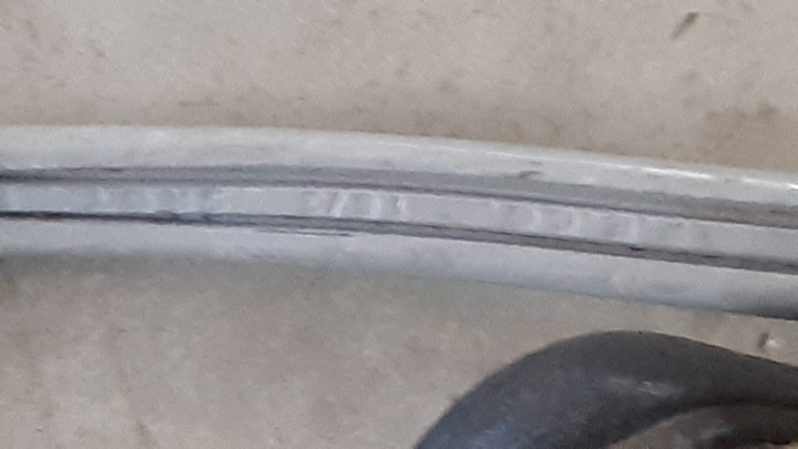

If not someone should tell Lincoln not to use 12g wire attached to a 50 amp plug.
I'm sure there is some excuse Lincoln can use 20 amp wire in a 50 amp welder.
The gray wire goes To a clothes dryer.
10g wire.

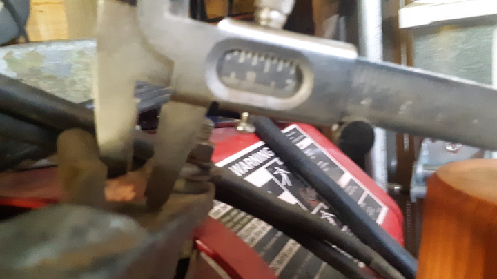

What guage copper measures 3/16 ?
This is what 225 amp Lincoln uses for welding cables.
How many amps can 3/16 copper wire handle if you are going by CODE?,

If you get inside the welder please post pictures and measure wire diameter.
