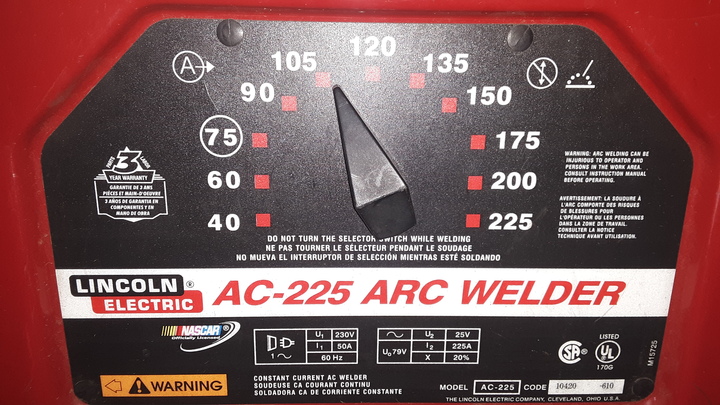

It shows 50 amps
Yet the power cord is rated at 20 amps
12g wire.
Shouldn't
50 amp wire be 6g, not 12g.
