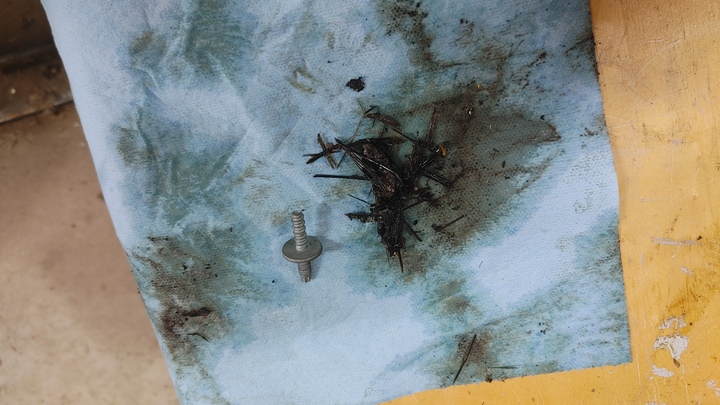

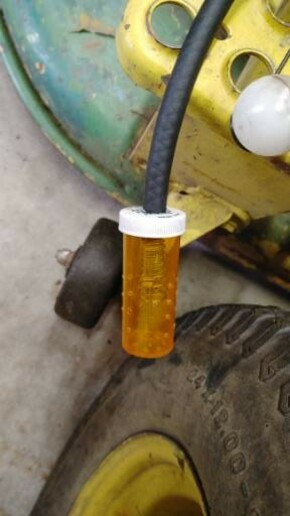

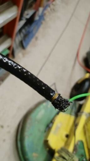

My JD 1145 has dual tanks with separate suction and return lines going through a splitter valve.
Last spring it would run for 10 minutes and run out of fuel. It would do exactly the same thing on
both tanks so I assumed the problem was after the splitter (how wrong can you be grasshopper).
After some new lines and a lift pump, I found the tiny screen on the suction lines in both tanks
were plugged. After cleaning minimal debris out of each tank and building a better mouse trap, it has been
fine.
