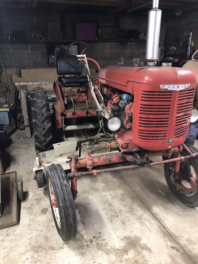

This is a Woods L59 on a Farmall A. In neutral, the blades
come up to cutting speed. In gear, the blades only come up
to half speed and the engine drags down 30-50%. I found
some Old posts that talked about the engine running too rich.
I adjusted the float in the carb but it hasnt helped. Thoughts?
