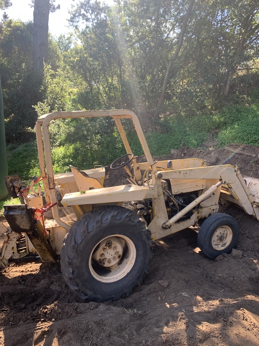

Hey guys I have a 1973 Ford industrial deck 4500 backhoe . It runs
fine for an hour or so then I am having an issue with the tractor dying
out this last couple days , it almost seems like it sputters like its

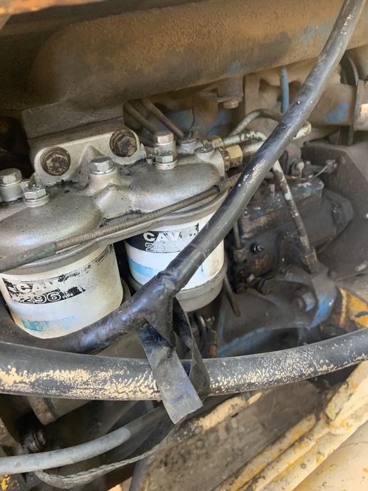

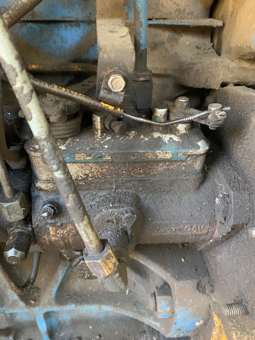

running out of fuel or pulling air into the system. The tractor will not
restart now , The tank has fuel, the drain valve at the bottom of tank
spews fuels when I loosen it, the return line when its running has
flow. I left it alone yesterday and bled the filter not knowing if that had
any help but it ended up starting up . It always starts right up never
hard starts or anything usually. Doesnt smoke , Compression seems
solid . Any help would be appreciated
