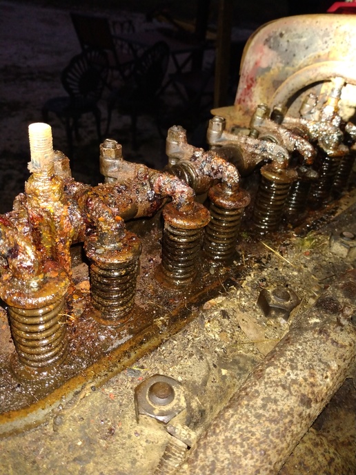

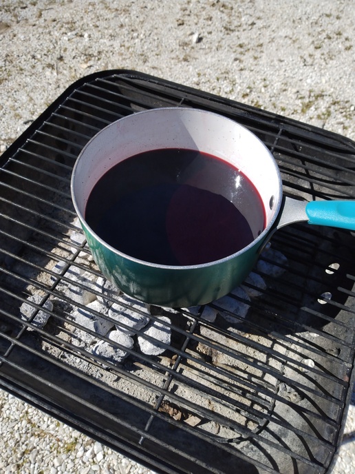

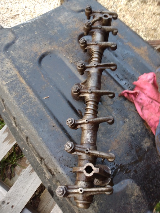

Bought the tractor in Dec. Finally got it in the barn. Took valve cover off. It was ugly in there. Pulled head, cylinders looked good. Pulled starter off just to make sure it wasn't the issue. Nope still stuck. Got the bbq grill out, fired it up and got a pan full of transmission fluid hot, poured it in over the pistons, had a front wheel weight hanging on the hand crank, with in 5 minutes the motor turned over! Got the head soaking in a tub of vinegar. It's gonna run again!
24 hours in vinegar, made a huge difference! Can't wait to see the head. Had 5 stuck valves
