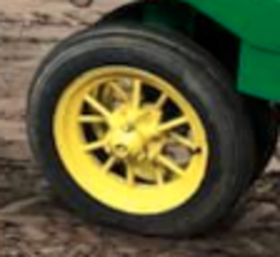

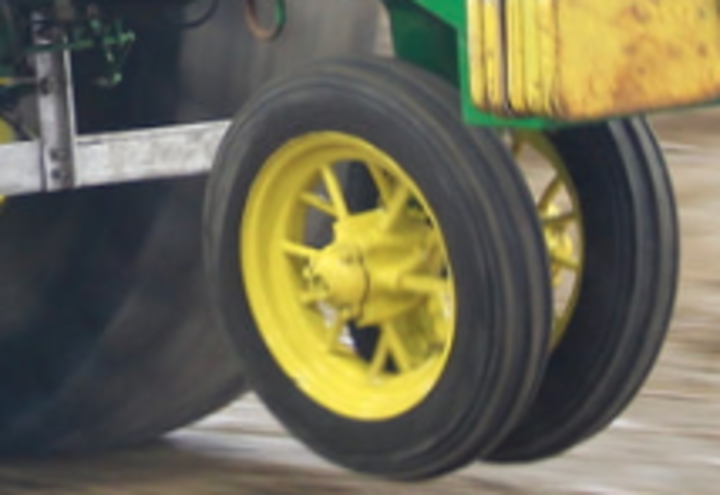

We made these over from a 37 A JD. Used new rims, cut the spokes as long as possible and then chucked the hub up in a turning lathe. Turned the spokes to just fit the new rim and welded them in. We have a wheel jig that centers them and holds the hub where you want it for correct backspace.
