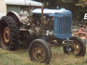

Fordson Major Before
As can be seen from this first photo, the tin work was fairly sound, the tires had begun to perish though, and the bake-a-lite steering wheel had at some stage been snapped.
As with most tractors, there had been a few working improvements over the years. Although relatively minor ones they included the addition of the later 1950 type vaporizer and an improved model of magneto. For reasons of working authenticity it was decided that these modifications would be retained in the restoration.
Someone had at some stage begun to take pity on the old girl and treated the red castings and the fuel tank to a coat of blue paint (albeit the wrong shade of blue).
The steering bushes were okay and showed little signs of wear unlike the pulley wheel bearings which were nothing short of a pile of grey dust. This lead George to the assumption that the machine had spent a great amount of time on a thresher box.

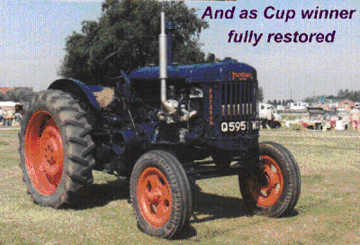

So once the steering wheel and new air cleaner top had been obtained the whole thing was rebuilt and minor details sorted out, resulting in a very good and authentic example as seen in the finished photo below.
Fordson Major After
