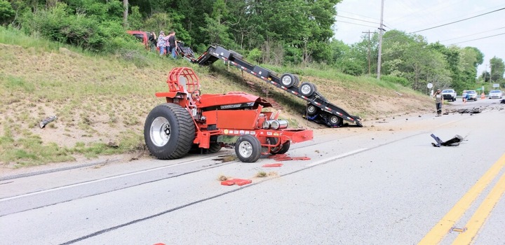

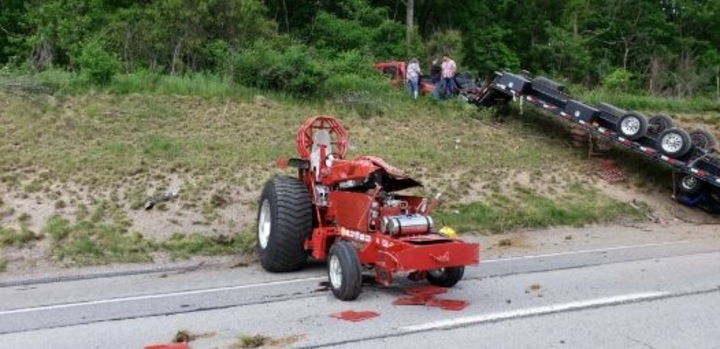

Gentlemen,My name is Donnie Hebenthal Jr and I am the owner of all of this mess and the driver in this accident. Just want to set a few things straight,my father had originally posted all this without my knowledge.This is the very reason I don't do much social media-the rest of the world always seems to know more than the individuals involved!
For the facts,The trailer was a 2014 17,000 lb Moritz with electric over hydraulic brakes.
The truck was a GMC 3500 Duramax with Allison with a 30,000lb B&W gooseneck hitch.7800 lb
Trailer curb weight 6400 lb
Tractor 8700 lb
4 wheeler 650 lb
1 safety chain stayed intact on OEM equipment.
Truck was legally combination licensed at 26,000 lb,and yes I do hold a Class A CDL and medical card.
Chains were 3/8 grade 70 transport chains with 1/2 to 3/8 Crosby grade 70 transport hooks on them
Total of 4 chains with 4 DOT approved ratchet binders plus 2 more 2 inch dot rachet straps side to side from tractor frame to trailer.
These vehicles took 3 separate hits
First being the mini van that hit us at a 45 degree coming from opposite direction.
Second being the truck hitting a 45 degree inbankment.Which I had swerved toward to avoid any other motorist(Just like DOT manual states should be done.
And 3rd the trailer over turning on the bank.
Furthermore Police,dot,fireman and ems ALL commended me on the job well done both with proper chains being used and my quick actions to avoid any further vehicles being involved in this accident.
NO! I was not cited for any violation in this accident.
Finally,for all you professional truck drivers-they also stated that the way the load was secured and hardware used was better than most professional carriers use on a daily bases that they encounter.
If not for my actions the lady that was responsible for the accident, my father and myself would not have lived through this.
As far as insurance:yes the tractor was supposed to be insured,they took my money for it but no they did not cover it.I now have an insurance policy with a reputable motorsport co.
Have a nice day😀
