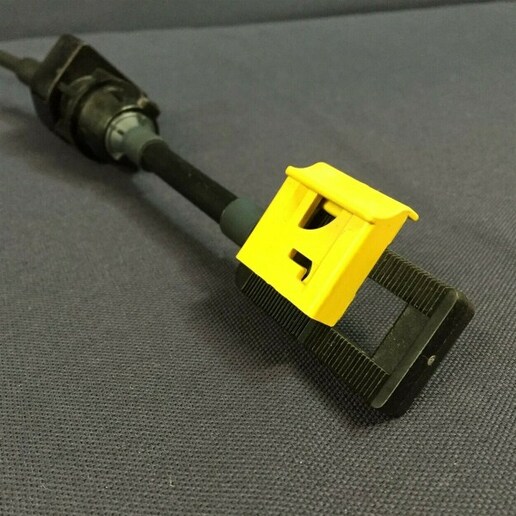

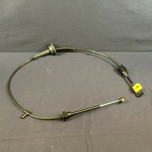

bracket. Nope wasn't the problem. The problem was the cheap shift cable.
It has an adjuster on the end of it where it hooks on the transmission
that you can slide back and forth and lock into place when you get it
all lined up. Such as truck in park and indicator in park. Lock the lock
down and you're all set. Problem with the lock is they can slip and get
the results you're getting. It will always go back into park because
you're pulling it to the end of the adjustment. Problem is when you try
to "push" it into reverse or drive and the adjustment will "slip" and it
has to go further so that's why your drive is in second and reverse is
in neutral. Get under the truck and see if you can lock the adjuster in.
It's yellow in color and you have to pull down on the locking mechanism
to lock it. I put a new cable on mine. Turned out it was just unlocked
and in good shape. I have my original one on the shelf. The new one cost
me $65 bucks on ebay. Was for a 4100 model. You will have to find out
which transmission you have. There are two. I will try to put a pic on
