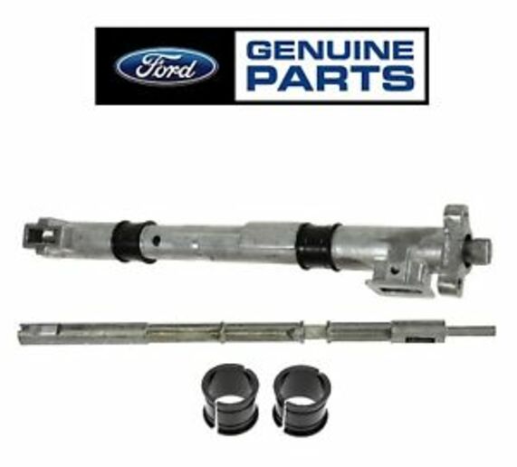

Here is the shift tube I assumed was broken but mine looked like brand new. I ordered a new one anyway with new bushings and put it in. It's not that bad to take the steering column down. You can do everything without pulling it completely out. To take the key switch out you have to shove a nail up into the hole in the bottome of the switch and turn it to accessory I think and it pulls out easily. That lets you get the column trim off and get the ball rolling. I was very glad to get mine working good again. I didn't want to own a vehicle that needed special instructions to drive it!!!
