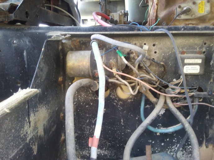

I have the same relay on my Kenworth truck tractor. Those2 little blue wires go to a remote starter switch that I added so I could start the motor while I was under the cab. If you short those two terminals, the truck will start.
