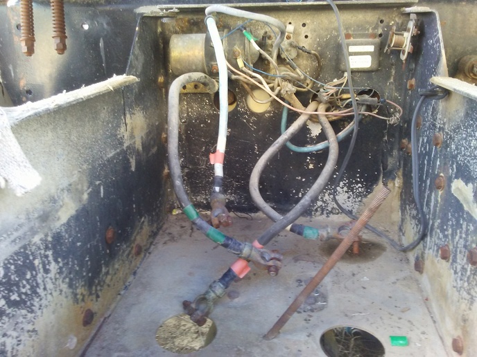

Here is a better picture. You can see the battery cables with two tapes of red and green hook to one battery and the cables with only one tape of red and green hook to the other battery. Then you can see where the two reds and the one green go to the starter.
