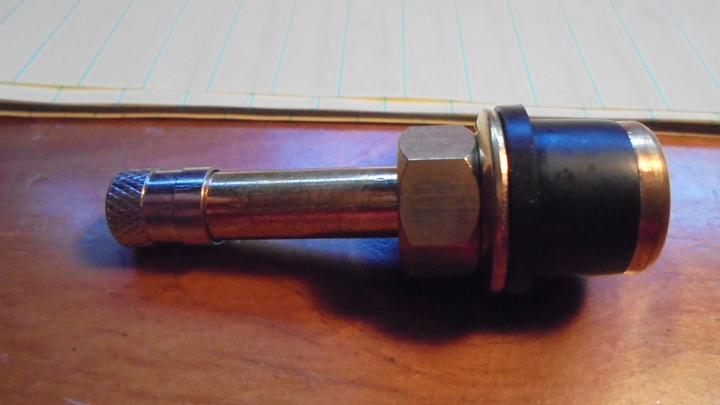

tire stem fix
Posted by grizz02 on May 13, 2019 at 16:52:49 from (174.31.185.65):
if you have a tubeless tire these work slick just pull out the old one or push it in, insert push through valve tighten the nut and air the tire up this one is for 5/8 hole but they make them in other sizes
