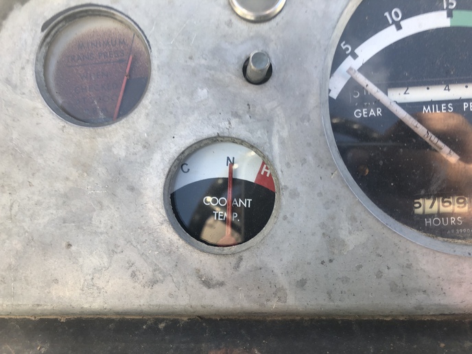

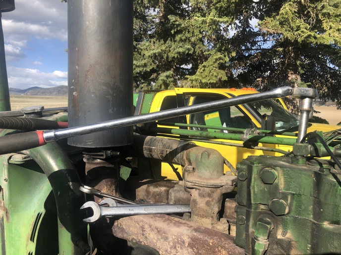

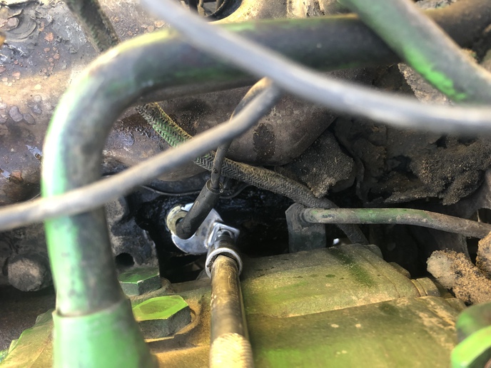

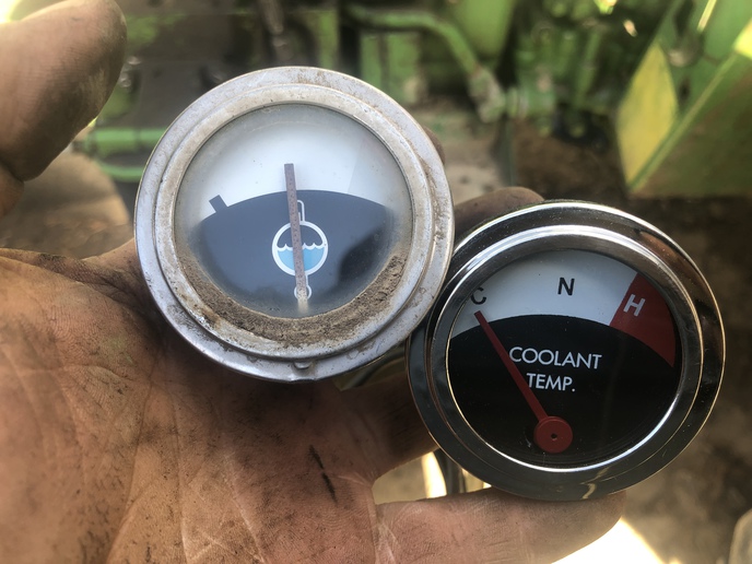

Anybody use a Steiner tractor parts temperature gauge ? I just put one on my 3020 . The sender was a little tight in the head on the original gauge it took my 2 foot custom built harbor freight ratchet to get it loose . Now I have a working temperature gauge again
Someone had installed the gauge from a later Serial number tractor at some point
