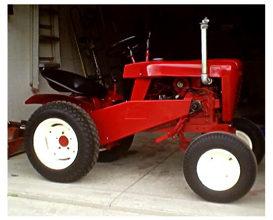

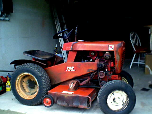

third party image
Ok, ok, it's a Wheel Horse. But this is where I started . Got a couple of these things, went to a few of the shows in Portland IN and the seed was planted. Since moving from IN back to KY a few months ago and getting our 10 acres I've bought a 9N and a 640.
But this is what it looked like when I bought it.

third party image
And after getting all the sheet metal sandblasted and then rattle can priming and then sanding and then priming and sanding etc.. I painted it with Rustoleum rattle cans. Seemed to work best for me if everything was primered before I shot my color. If you paint something that say is red and dont prime it, any spot that's not red, like a rust spot you brushed and spot primed etc.. it takes forever to cover. A nice even primer coat lets your color coat go on much better. Or lets it appear to go on better I guess. What worked best for me was to give a couple of light coats of color to get a good base color down and then finally the last coat goes on thick and that's what makes it look shiney and not like a 10 year old painted it. At least that's what worked for me. Now someone that runs a body shop could have looked at it and sneared, but any of my friends and family that saw it were surprised to find out it was a spray can job. There was no overspray etc.. I took pains to do it as good as I could. Then later I sold the little thing. Wish I hadn't done that!
