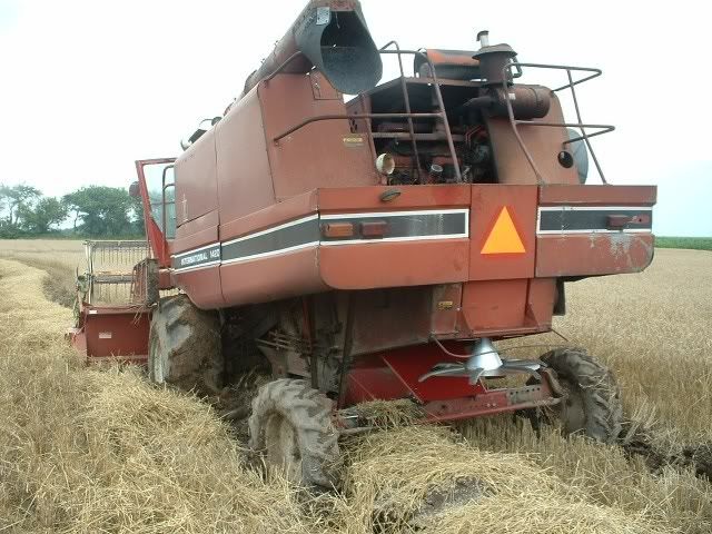

third party image
I hope the 6030 JD will drag it out.My 1456 IH has a busted inj pump.

Anyone who has ever owned one of the beasts has stuck one. The main problem is getting them out without bending them or pulling them apart. Good luck.

Blaine, you better get a backhoe in there as well. What SD Pete says is true, and you've already told me this is the same one which broke the front axle housing last year. I'm really afraid the combine is already weakened from that prior damage.

Been there done that. To pull out without causing frame damage I would hook the chain to the back axle at a right angle to the machine and twist it out.

????? ?????No frame damage by pulling at right angles and 'twisting' it out? Run two chains underneath to both drive axles and pull it straight out to the rear. Put duals on. Get a Gleaner which actually has a decent frame- I've never been stuck so much that I couldn't pull it out to the rear, using the steering axle.

I totally agree with running two chains or cables UNDER the rear axle and to the front, wrapping around, close to the separator. Pull straight out. Tension should raise the back up out of the mud in the process. The strain is even and won't risk twisting or bending the combine's frame.

I've seen neighbors run two cables back to the steering axle (before they went to the field), terminating in a heavy ring, so it's already in place, during a wet season.

Thats what we did to get my M2 out. The thing was buried past the first step on the ladder. And used the neighbors Big Versitile to pull it out slow and easy. Took 3 seconds to stick it and a couple hours to get it out. :-)

This morning a neighbor and I tried twisting out the 1420 IH using my 6030 JD but we only got it moved 3 ft.If my 1456 had been running I believe it would have pulled it out.There is water standing in the ruts.My neighbor will bring over his 4760 JD Monday morning if it doesnt rain.
In the 48 years that I've been around SP combines I expect that Dad and I have been stuck well over 200 times on our farm and while custom cutting for the neighbors.We have pulled them out,dug them out,winched them out,let them sit until it froze up,etc.We have had to use 2 tractors more than once.

We got stuck 8 times with the Arps half tracks on and my 856 IH pulled it out every time.This was no ordinary 856 as it had been built new as a pulling tractor.In field trim it could be turned up to 190 horses.It had a TD-15 dozer turbo,lots of pump work,special clutch,etc.It had 24.5x32 inside tires with 18.4x38 duals and would absolutely walk on water as we kept it light..It never failed to pull our combine or tractors out but also pulled out numerous neighbors.It once twisted out a stuck F Gleaner that was high centered with 100 bushels of milo on.My local wrecker man said that we were the only ones he didnt winch out at least once in 1974.
We cant figure out why its so wet here.2005 and 2006 were real dry and we have never had over 5" of rain in any month this year.They have had far more rain just to the south and west of here.
