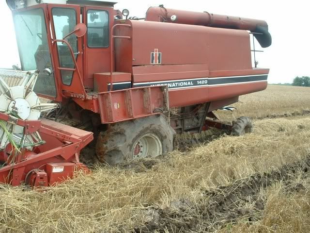

My luck in the mud ran out this afternoon.I slid down the hill side in to the previous rut and there was no bottom.Its almost impossible to steer them with no RWA.This is the worst mud at wheat harvest since 1981.
I need to get this field done so we can burn it and get it dried out.Time is growing short to get double crop beans in the ground.
There was rain all around here at noon today but it mostly missed me.

I hope the 6030 JD will drag it out.My 1456 IH has a busted inj pump.

Anyone who has ever owned one of the beasts has stuck one. The main problem is getting them out without bending them or pulling them apart. Good luck.

Blaine, you better get a backhoe in there as well. What SD Pete says is true, and you've already told me this is the same one which broke the front axle housing last year. I'm really afraid the combine is already weakened from that prior damage.

Been there done that. To pull out without causing frame damage I would hook the chain to the back axle at a right angle to the machine and twist it out.

????? ?????No frame damage by pulling at right angles and 'twisting' it out? Run two chains underneath to both drive axles and pull it straight out to the rear. Put duals on. Get a Gleaner which actually has a decent frame- I've never been stuck so much that I couldn't pull it out to the rear, using the steering axle.

I totally agree with running two chains or cables UNDER the rear axle and to the front, wrapping around, close to the separator. Pull straight out. Tension should raise the back up out of the mud in the process. The strain is even and won't risk twisting or bending the combine's frame.

I've seen neighbors run two cables back to the steering axle (before they went to the field), terminating in a heavy ring, so it's already in place, during a wet season.

Thats what we did to get my M2 out. The thing was buried past the first step on the ladder. And used the neighbors Big Versitile to pull it out slow and easy. Took 3 seconds to stick it and a couple hours to get it out. :-)

This morning a neighbor and I tried twisting out the 1420 IH using my 6030 JD but we only got it moved 3 ft.If my 1456 had been running I believe it would have pulled it out.There is water standing in the ruts.My neighbor will bring over his 4760 JD Monday morning if it doesnt rain.
