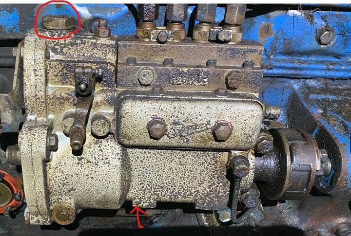

Thanks for your explanation.
I have just uploadet a photo of my pump.
I cannot find the oil level screw.
Is this pump lubricated by the diesel oil and if so, why are there a big nut on top for adding oil?
Do I need to add diesel by this inlet?
At the bottom of the pump, where the red arrow point, I removed the screw and drained the liquid, which was not oil.
On the side of the pump, I cleaned the plate with the model no, which says P4596
