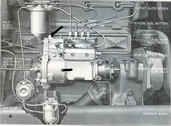

It depends what pump you have on your tractor. The early Super had a vacuum governed pump that does
not have oil in it, it mis lubricated by the diesel itself. Later tractors had a Simms MiniMec pump
which has oil in the governor housing to lubricate the mechanical governor only.
I have marked the fill and level points, the drain is underneath. The plugs go into an aluminium
housing so be careful and do not over tighten them.
