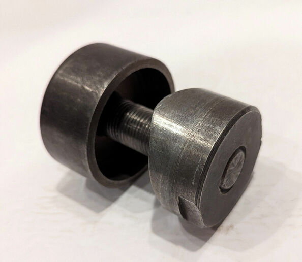

No. The light circuit is not carrying load. (disconnect the battery before doing this) At the starter solenoid a single big wire comes from the battery. on that same post
is a smaller (10 gauge) wire going to the Bat terminal of the Regulator. Disconnect it and splice a 10 gauge new wire to it. Run that wire up to the location of the amp
gauge. From the amp gauge run another 10 gauge wire back to that dame post and connect it where the first wire was removed. This puts the amp meter in series with all
tractor loads, into and out of the battery. (except starter load which is in hundreds of amps. The link is to a chassis punch. Buy or borrow one from an electrocal
contractor. Jim
