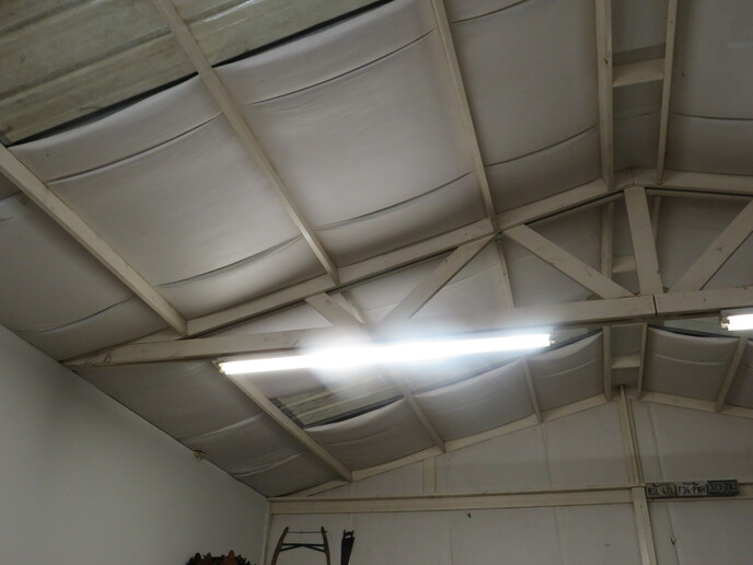

On 16 centers #1 would be plenty sufficient. If it were me though I would make one heavy truss more similar to #2 in the center and run purlins between.
