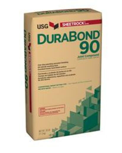

Is there some type of product that will adhere to
the old hard concrete?
I don't know if this product is salt proof.
I can tell you it will adhere to concrete and it
is waterproof.
I had to drill holes in my basement wall to run
conduit and water lines out. I used 90 minute
durabond to fill in around the conduit and water
line.
Not sure how thick you can apply this over old
concrete. About 1/8 inch at a time. Unlike other
drywall mud, this stuff doesn't shrink after it
drys.
It might be worth a try.

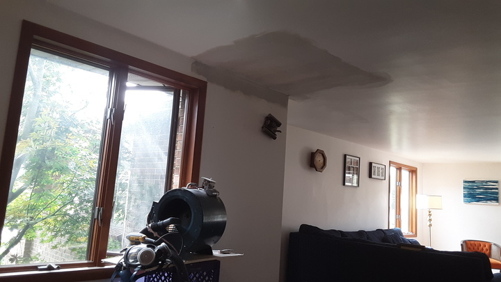

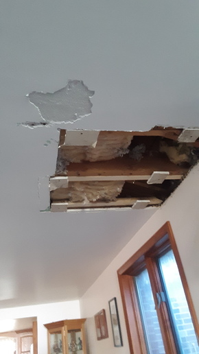

I use 90 minute durabond for my first coats of
mud when I drywall. Set the tape with durabond
too.
I sanded the durabond before top coating it with white drywall mud.
I'll guarantee you I won't have drywall cracks or tape failures.
