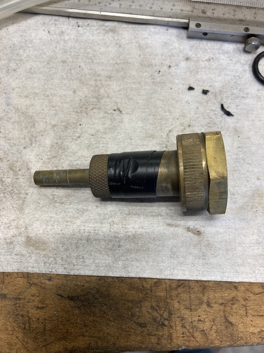

I like this style of liquid adapter. The black tape is covering the bleed hole that lets air out when filling. I use the tape to let me pull suction when draining a tire.

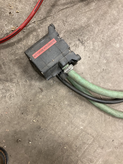

The pump I use is an air powered diaphragm pump. Meant to move chemical so the chloride doesnt bother it.
