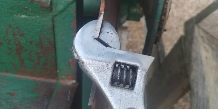

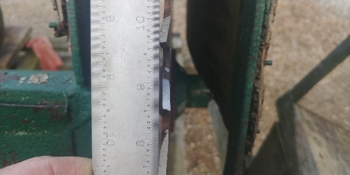

Checking the set and how to change it. SET IS VERY important on any saw but ultra important on a buzz saw because of the imprecise manner they are operated. Check with straight edge and use a crescent to bend teeth. If you feel the need to be precise you can make or buy a set guage. I use eyeball,, once again, we are not making cabinets, cutting firewood.
