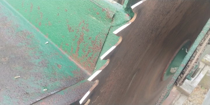

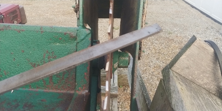

There are actually two ways to sharpen one. On the face or on the back, some may argue that one way or the other is right or wrong the thing to remember is if it is sharp and cuts its right, were not cutting cabinet stock. I use a file, but you may also use a 4 grinder with a new flat disk if you are careful. I sharpen the back because its much easier when the blade is mounted on the saw. Shown in pics is one I just worked on yesterday. Always push the file the way the tooth is angled. Lower the handle from flat so you edge is angled a bit. Also important is set, you need 1/8 to 3/16 set, also shown in pics.
