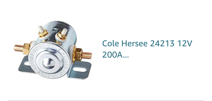

While all the solenoids may look the same from the outside, there are differences on the inside. Most are rated around 70A. Recently I was looking for a solenoid to put on a 44D. I found this one that has different contacts and is rated at 200A.
Also, the starter relays that Deere uses must be pretty decent. I used one as a temporary replacement for the snowplow on my pickup. That was 10 years ago and it is still working fine. Also the one I used was a takeoff at that.
