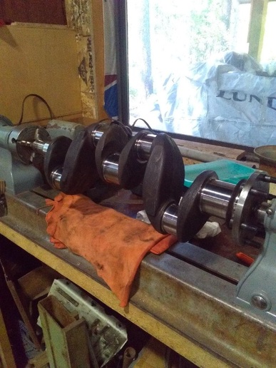

If you decide to get it, send me an email and I'll go through the steps I did for the crank in my Continental 4 cylinder. Not a bad journey, and it turned out really well. Cost a few hours, and less than $20 to polish up all the journals. Used my wood lathe as a holding fixture. Good advice from others to get some measurements from the seller, before you invest. If you haven't already, find the journal specs for yours before you get too deep into this one. PS: Glad you got some good tires, so I didn't have to ship mine to Minnesnowta!! steve
