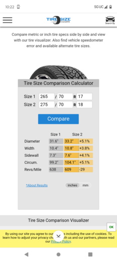

Both pickups use the new 8-180mm lug pattern.
My question is about tire size.
My 2013 has LT265/70 R17
The 2023 has LT275/70 R18
I found a tire chart that lets you compare
dimensions.
Screen cap of that below.
Please check my math but I think using the
18s would have me running 68 mph when the
speedometer shows 65 mph.
Is that a big deal?
Price is right on the 18s.
Would you do it?
