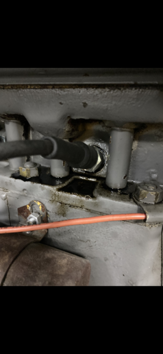

Bought this little TO-20 awhile ago and while using it recently it seemed to develop a oil leak out of the spark plugs? I pulled all 4 and they were very much coated in black carbon. I replaced all 4 after making sure the plug holes were clean and they continue to weep. I did a compression check and got 90-90-85-80 psi. I did a oil compression test and got roughly the same psi. Seems like its a head issue? Any ideas gentlemen?
