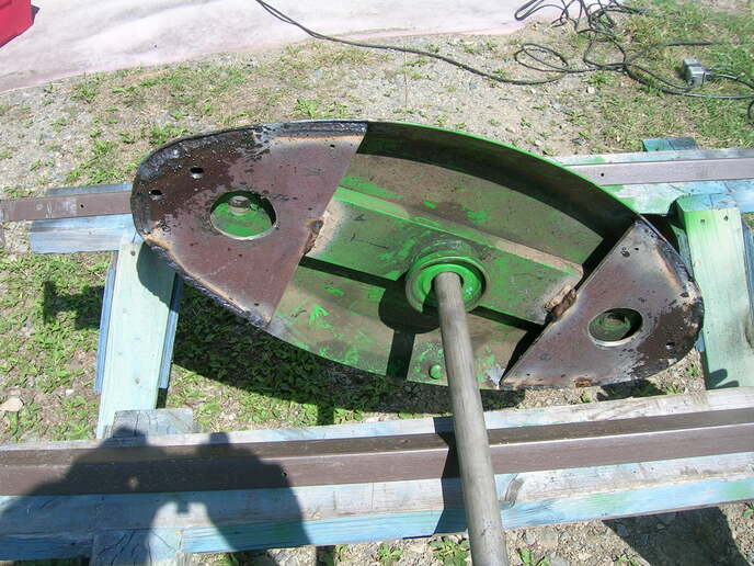

That is a sturdy stump jumper! If I have trouble with ours again I going to try to find an aftermarket one
for ours, but Bush Hog seems to have a different output shaft on the gearbox. This is what ours looked like
a couple of years ago after I reinforced it. But 2 weeks ago the center hub broke out of the bar, so the blade holder and blades were laying on the ground behind the cutter. I had to split the hub to get it off, even though I used anti-seize on it, and always keep it inside. Anyhow, I got it all welded together again and have used it about 10 hours with no problem. We have a lot of rocks and stumps, so I set it to mow higher and I loosened the slip clutch a little.
