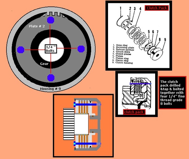

This is a picture from big Dean's CD years ago
Multi-Power clutch lock
