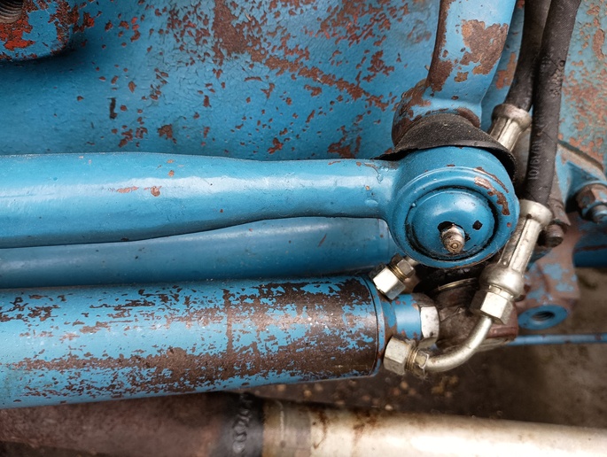

I haven't done it on that model but have done it several times on other Fords.
Find a tierod end that fits the hole in the steering arm, cut off the old one and weld the new one on.
Costs about 1/10 of a new one.
I do a bit of grinding, add a bit of bondo and paint and you can't tell it from oem.
I did the ones on this tractor at least a dozen years ago.
