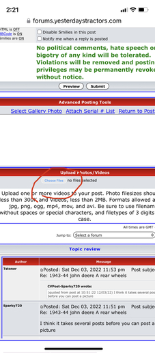

It would be nice to see the exhaust problem you have
here is a run down of how to post photos.
Pictures post through the ..Browse or Choose files..
button just below where it says ..Upload
Photos/Videos.. down lower in the ..New post and reply
windows. See photo to see an example on my iPhone.
Clicking that will give you a choice to select the file or
folder the pictures are stored in on your PC or phone.
Then select the photo from the file and ..Add.. it. They
cannot be pasted into the text area as a file. I would
suggest only adding 1 or 2 per reply to see if your
photos are below the file size limit.
