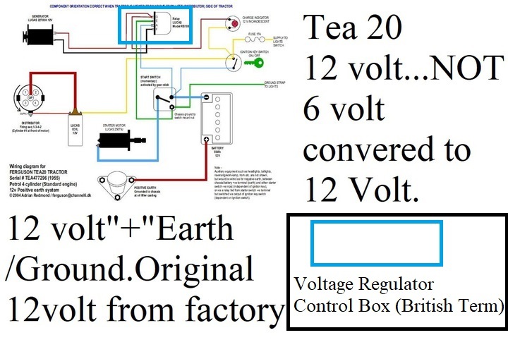

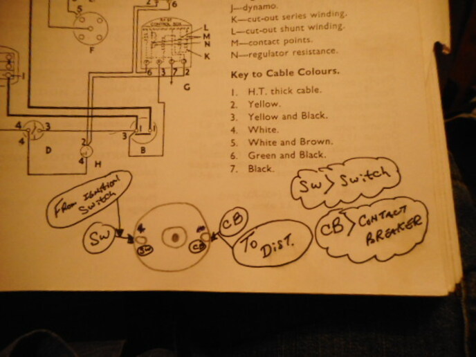

History on this Running Tractor up until it NOW will not Start.
Notes I made 20 + years ago...
Firing ORDER 1-3-4-2
Remove wire at COIL that connects to Ignition SWITCH....(SW)
Then run a Jumper wire from Coil to Battery post (-).........(bypassing Ignition Switch)
Crank Engine and check for Spark at plugs..
