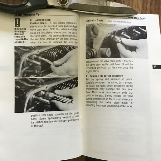

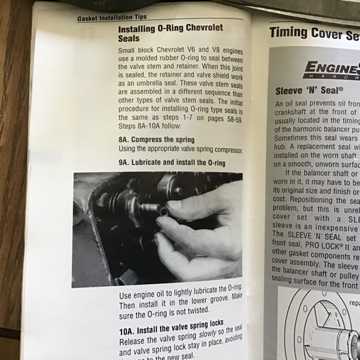

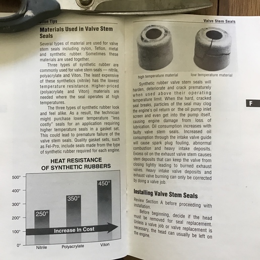

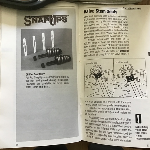

Copied this from Fel -Pro for you to review ,
