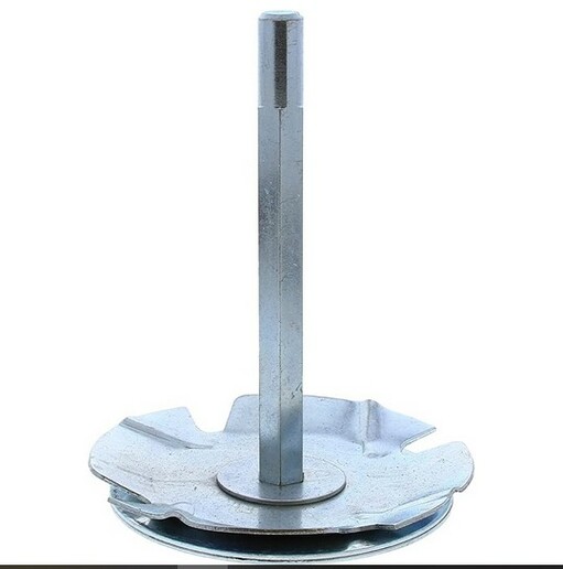

Not sure what code you are uses..
Sewer is sized by DFUs.
According to the ICC, your 3 stack should be good for 48 DFUs. Your bath and clothes washer should be 7 DFUs (if I read it right). You will have to add the other two lines up. If you have to, they make a drill bit to cut the pipe (bushing) out of the hub. Google Hub Saver
