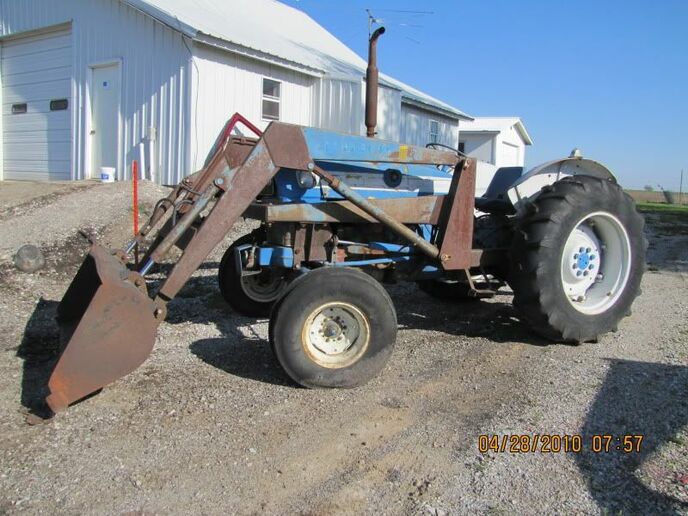

A 772 is a conventional loader in that the
frame goes back to the rear axle. It also
has the uprights where the rear of the lift
arms pivot.
I'm thinking there is no way you are going
to get one on on your tractor without
mostly destroying the cab.
Here is a 772 on a 4000 I used to have.
A 4000 and 4600 are identical tractors.
