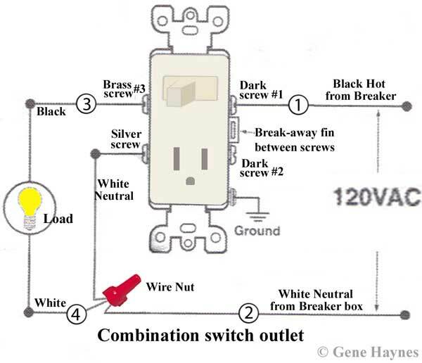

For the most part some electronic devices can be damaged by reversing the polarity. It can also make it dangerous for someone else working
on the wiring if the wiring is reversed. It's not difficult to get it right. Looking at the switch in the link the side of the outlet on
the right with the small prong is for the hot wire (black) and the white wire goes on the left. Here is an illustration.
