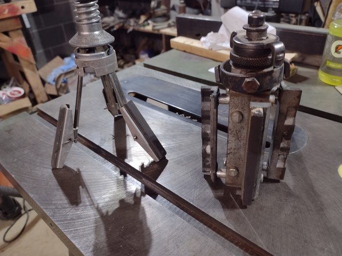

Left is a glaze breaker, right is a Sunned hone. Both require a slow-turning drill. The hone takes a lot of torque while it's cutting.
