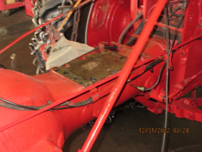

Last Saturday afternoon I took the Super C out to try getting the driveway open. I got it open and was backing in the shed when the right control lever for the touch control hyd got pulled out of my hand. I found a big cotter key tore up on the rockshaft that also destroyed the control operating link.
Looked like junk to me so I went over to the junk yard and got another one. Kind of handy for Farmall parts only about four or five miles away.
