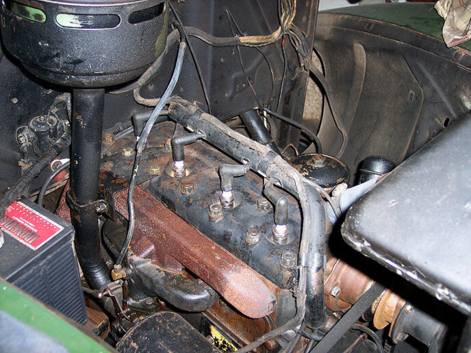

Heres the engine- a 9N tractor engine with a fuel pump.
All 9n engines have the the lobe on the cam to drive the pump, but only the T stamped blocks have the mounting provisions fully machined into the block. THey even use the tractors unpressurized radiator.
