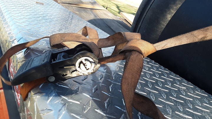

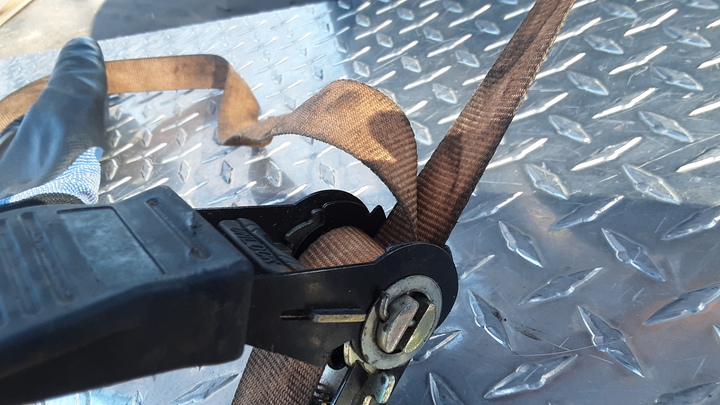

The farmer showed me this trick.
He puts the loss
End of the strap in the ratchet and continues to tighten the strap.
Then make a few slip knots.
I strap and chain my tractors
When hauling them.
Chains to prevent forward and backward movements.
Straps to prevent lateral movements
