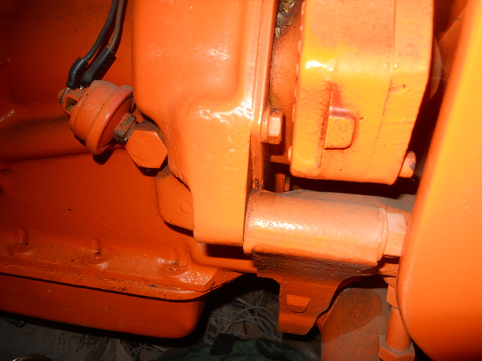

on the right side of the motor, near the generator; there is a flat spot cast in the block. There are numbers there that can be used by the Territory Service Manager of your local John Deere Dealership to get you the ser.# for your tractor. The number stamped isn't your tractor number, but can be used to acquire your correct number. The new ser.# tag will have the modern barcode printed on it. Good luck. I know our 40 has this number stamped in the casting.
