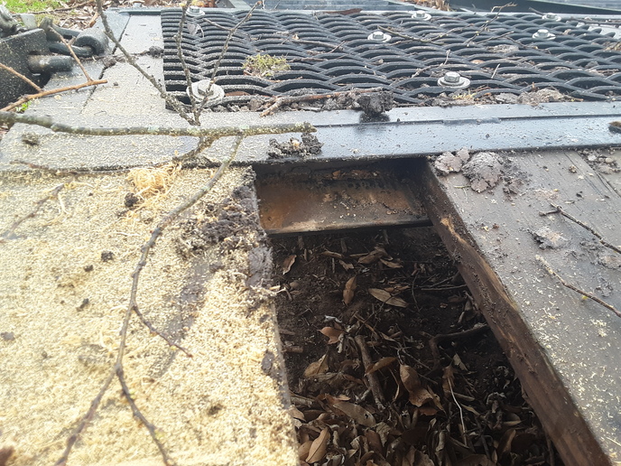

I would not put shingles on treatment lumber.
I did that on a rental property and a year later the wood under the shingles was rotted.
Tenant put flower pots on wood deck.
The wood under the flower pots was rotted.
The wood not covered was fine.
Pressure wash wood. Use bleach.
Get rid of the dirt and any mold.
I put expanded metal on my implement trailer dovetail because they got slick when wet and snow.

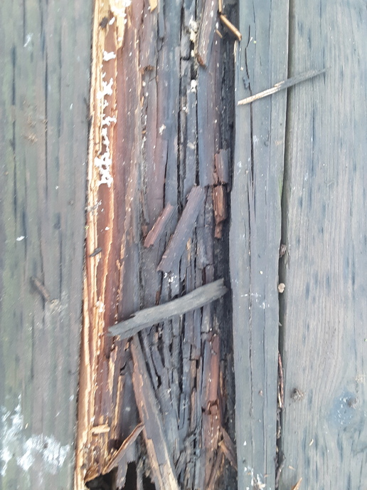

I put used motor oil on my trailer deck and had to replace 2 deck boards a year later.
I'm convinced deck Boards have to dry out or rot.
Your decision.
You can see the expanded metal I used on implement trailer and rotten deck board.
Use expanded metal no shingles
