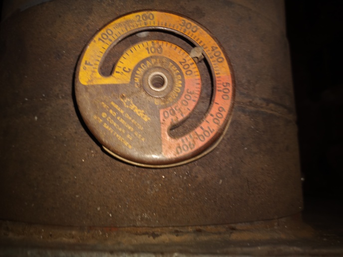

My experience is no matter what kind of wood one burns, the dryer it is, the better for your chimney it is. Here in the farmhouse my dad was raised we had the chimneys rebuilt or relined in the 1980s. A chimney sweep relined 2 of the 3 chimneys. He said that dry pine, we like the spruce pine, will burn much cleaner than the finest damp hardwood. His advice was to get one of the round stove thermometers and put on top of the stove or the flue pipe to help one remember to burn the fire hot enough to keep the stove and chimney clean.
