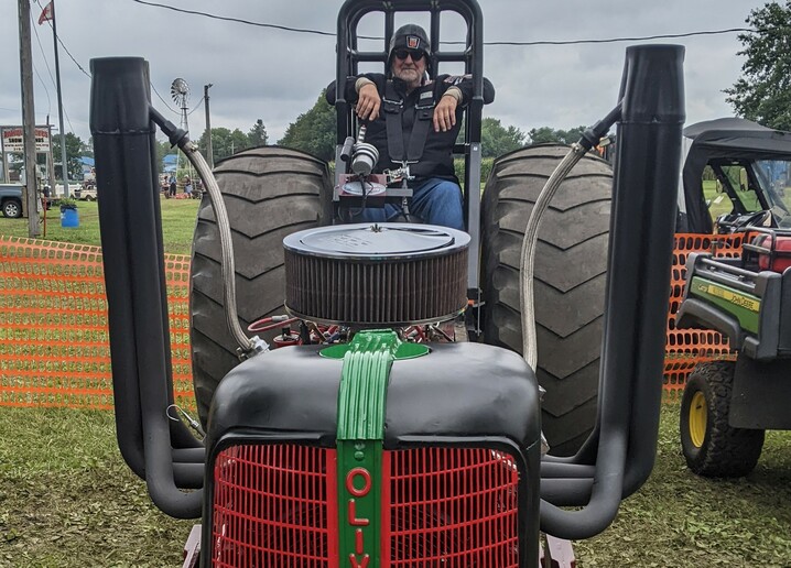

I bought it on Big Iron Auctions in March--They call them econo rods or retro rods. I've been working on it off and on since. It has a Cockshutt 40 rear end with a Chevy 454 engine and a 3 speed auto. behind it. I narrowed the front end a foot-Raised the cage 8 in.-the seat 7 in-moved the steering ahead-moved the hand throttle-changed the weight bkts.-built the Olly front end-and blasted and painted the headers-reversed the rear hubs-took me 3 days to get the left one off-broke my store bought puller so I made a super heavy duty one-with that and my inch impact I moved it 1/2 in. the second day and was very happy-fought it tell the end-put my 23.1/34s on and the list goes on.
My Eddie Rickenbacker leather helmet!!!
