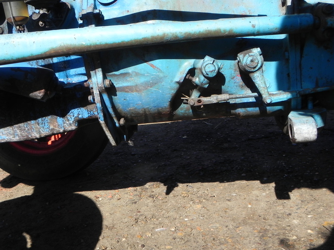

This is what it looks like on a Fordson Dexta but should be very similar. Front hole-normal operation, rear hole-when you need the PTO. I always go back into the front hole as soon as I finish using the PTO, do not have to lift your leg so high to change gear.
